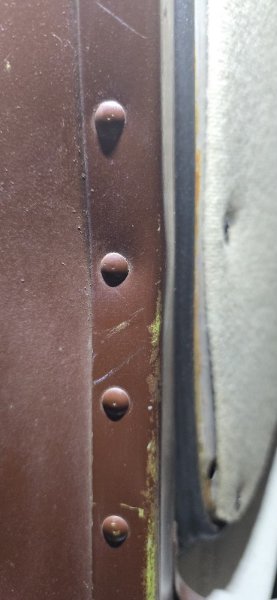

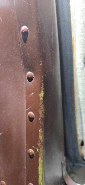

mild wrinkle in door post?
Posts: 2541
Re: mild wrinkle in door post?
It's still really hard to tell from photos exactly what the problem is. It looks like the rivet at the bend was driven in too hard (or the bucking bar wasn't heavy enough) and the bend radius for that flange is too tight right there, but, it's a compound bend there and it may actually be acceptable.
Is there anything in the logs about damage or repairs to the fuselage? Do you have any idea how long it's been like that? Is it a very early serial number? Many of them had the door posts replaced in the field. Is there any evidence of cracking in the bend radius?

6643 wrote: Sat Mar 29, 2025 4:27 pm It's still really hard to tell from photos exactly what the problem is. It looks like the rivet at the bend was driven in too hard (or the bucking bar wasn't heavy enough) and the bend radius for that flange is too tight right there, but, it's a compound bend there and it may actually be acceptable.
No cracks. This whole plane has been smashed by trees etc during its long life. It was a flight school plane in NY in the 1940s and got resurrected a couple of times.
I am pretty sure this part of the doorpost hasn't changed at all since I have owned it. I didn't consider it any sort of potential problem until I asked an IA to sign off the annual (which has taken awhile due to my rear bulkhead replacement project because my whole field is shut down except the Cirrus shop, and he doesn't do metal stuff any more). Anyway this particular IA maintains about 14 planes for a local family including a citation, and I don't think he is used to looking at this type of old machine, so he didn't really want to dig into whether it was OK or not. So he suggested I run it by some other people. Which I am doing :-) There are other funky aspects to this side of the fuselage as well. Keep in mind I have put about 120 hours on it looking pretty much exactly like this: https://www.dropbox.com/scl/fi/mxb29v1p ... rmgwu&dl=0

Not an A&P but that does not look like it would seriously compromise the structural integrity of the door post.
Posts: 2541
bc12d wrote: Sun Mar 30, 2025 2:57 pmthat does not look like it would seriously compromise the structural integrity of the door post.
I'm inclined to agree, but, I also am inclined to think that the bend radius in that one section probably doesn't meet the minimum for that thickness of metal. Is that enough to affect airworthiness? That's above my pay grade.

bc12d wrote: Sun Mar 30, 2025 2:57 pm Not an A&P but that does not look like it would seriously compromise the structural integrity of the door post.
It hasn't moved in 120 hours of learning to fly, if that is any measure of structural integrity.

Found an IA. He isn't worried about it.
Thanks for all your comments and input.

I am rebuilding two Cessna 140's (1947} one had a damaged door post such as yours. It went over on its back and has wing tip damage and a bent lift strut. I replaced the door post on the pilot side and the metal from the firewall back. If I were you I would go back through the log books for a rebuild of the aircraft. I also have replaced the vertical fin and repaired the rudder. Look for 337 for repairs. Door posts do not just bend such as I see during normal use. Could have been a hard landing. I would look for other damage.
