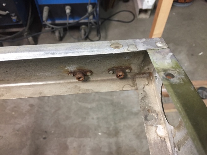

Is there a secret source for 3/32 cherrymax rivets? Spruce seems not to have anything smaller than -4.
I don't feel like I am trying to do anything weird here. Surely someone has tiny center pull rivets like the other wing has.
Posts: 2819
Re: Aileron control rod connection screw
Are these to retain the nut plates? Otherwise, 3/32" rivets are not structural.
If you can get the nut plates in there, can't you get a bucking bar in, too?
Cherry CCR264 (countersunk) and CCR274 (universal) Nutplate rivets are available in 3/32".

6643 wrote: ↑Tue Feb 18, 2025 5:46 pm Are these to retain the nut plates? Otherwise, 3/32" rivets are not structural.
Yes the right wing flap hinge nutplates are held in with countersunk 3/32 cherry max rivets. They are countersink into the wing spar, though. So the nut plates are probably normal on the inside, not countersink. I think I posted a pic above showing those nutplate rivets.
I got the nuts off the back of the left wing flap hinges, but riveting in some nut plates seems like a better way to go, especially since the rivet holes already exist in the rear spar (or whatever that piece of metal is that the flaps attach to).

Ok so Univair has them superceded by MS21047-L3, which seems to not have an elastomeric lock, but rather is all metal. I seem to recall people not liking nylock hardware for these blind applications, as they are only good for a few uses. So I will go for the metal ones I think: https://www.wicksaircraft.com/shop/anch ... g-ms21047/
The originals were elastromeric lock nuts that were riveted in using standard countersink rivets. I replaced the ones in the photo with new.
Posts: 2819
atypicalguy wrote: ↑Tue Feb 18, 2025 10:50 pmI got the nuts off the back of the left wing flap hinges, but riveting in some nut plates seems like a better way to go...
Just nuts? That's sketchy at best. The nut plate distributes the load over a much larger area. Maybe with a large area washer...
I don't see anything wrong with using pulled rivets as it's non-structural and non-critical.
The original nutplates had a fiber material in them. Nylon ones are the correct replacement. That said, there's proably no reason you couldn't use the all metal ones. Ask your PMI. Like I said, how many times do you anticipate taking the flaps off between fabric replacements?

6643 wrote: ↑Wed Feb 19, 2025 8:25 am
Thanks. I also thought just nuts was "just nuts". I don't know who thought that was a good idea. Clearly it was manufactured for nut plates.
If the wing were apart then I would use standard rivets. It is hard to get a finger in there let alone a bucking bar. We used fancy tungsten ones for the tail bulkhead but this is even more restricted a space than that.
