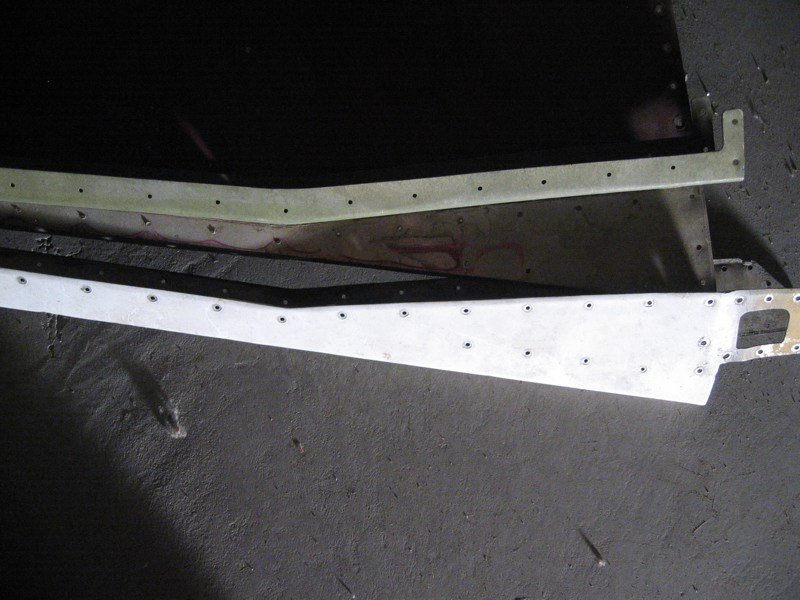

bend in horiz leading edge skin at root
channel on top of stab, leading edge in front (1).jpeg (84.44 KiB) Viewed 15342 times
Every one of these skins I have seen is cracked or bent where the elevator flexes at the root, just inboard of the inboard end of the reinforcing strip. It is visible here at the thin strip part around the square cutout area. It does not look structural at all, as it buckles upward and there is no rivet to hold it down where it buckles. I guess I question whether it is worth replacing the entire skin, given it is going to flex exactly the same way with a new skin and break again. Patching around the square with some cherrymax rivets and 032 aluminum seems like a reasonable fix. I already have the reinforcing channels installed, so no other reason to drill out the entire leading edge skin.
