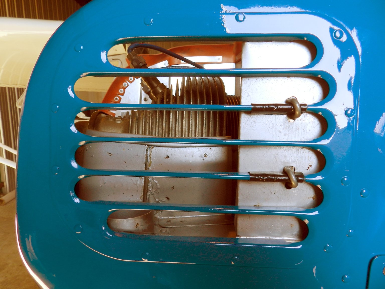

I cover my grills about 1/4 or slightly more in the winter, but I"m in the pacific northwest with a fairly maritime climate. Home made covers
4-13-15 009.jpg (230.96 KiB) Viewed 11200 times
There's a schematic for making a nice set, probably in the club maintenance manual?
