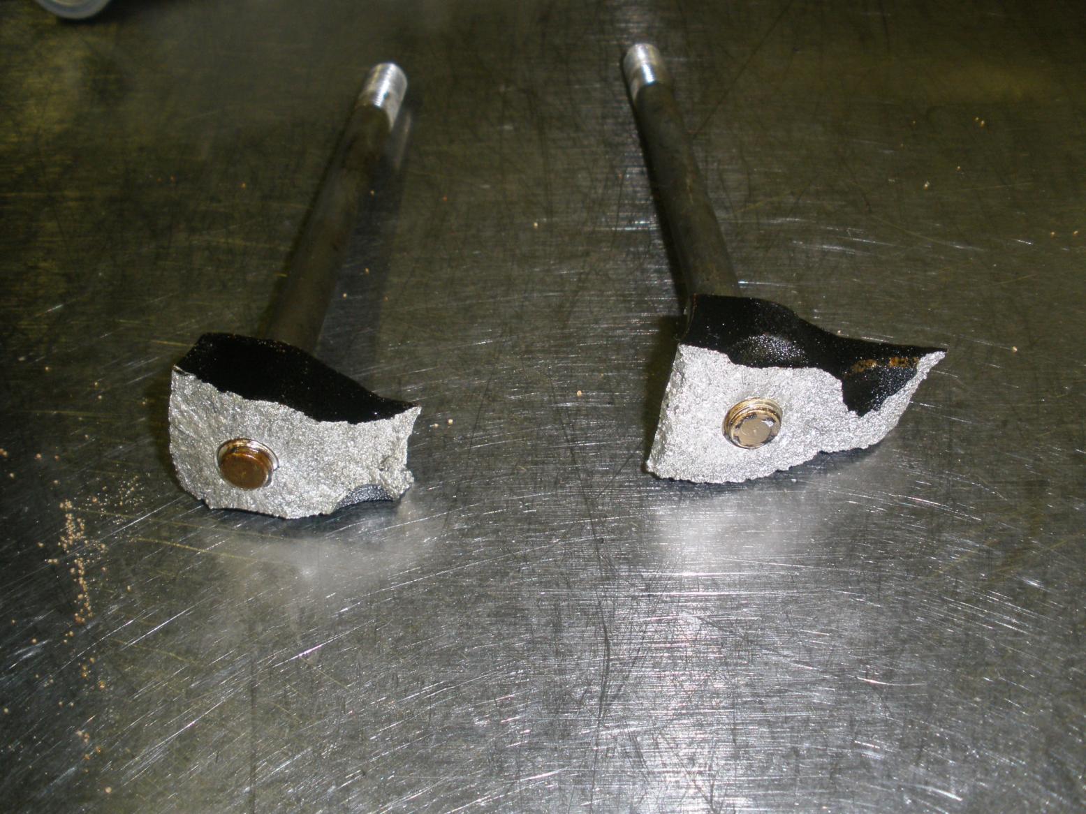

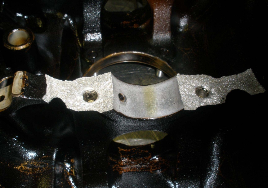

As far as I know, all C85 engines used in the 120/140 came from the factory with studs, not bolts. The through bolt case seems to have been introduced about the same time as the O200. The area where the studs screw into the left half of the case is a weak point and the added stress of the larger displacement, increased compression ratio and higher RPM may have been the impetus for the change. (Photo attached). The studs are a carryover from the A-series cases.
If you look the parts catalog 1977 edition page 2-5 at the notes at the bottom you'll see the part numbers for the studs on the "obsolete case".
If you have a through bolt, the opposite end will be loose. Put a wrench on it and give a little clockwise torque and see if it turns.
If you have through bolts, they can be reused (as can the studs).
How to post photos.

- case-1.jpg (297.29 KiB) Viewed 7801 times
- case#2.jpg.jpeg (253.52 KiB) Viewed 7801 times

My #2 cyliinder I have marked for the thru bolt, 0-200A, part number 627275, bolt, thru, 7/16 x 10-39/64 inch long. I saw your post on the Facebook site. You'll need to pull the cylinder to replace, but I'd be more interested in any damage you might (hopefully not) find inside. Good catch on the pre-flight.
Here's an internal shot at the left half case of my 0-200A showing where the 627275 thru-bolts go and the bumps in the case for the cylinder base studs. You can see what I'll call 'thru studs' on the left for attaching the cases together. Similar 'thru studs' from the right case up by the thrust bearing.
What John was referencing on the older cases, this example from an A65 Easy check, go to your #3 cylinder and see if the nut at the 10:30 position turns easily. If so you have the 627275 bolt, thru that failed.
