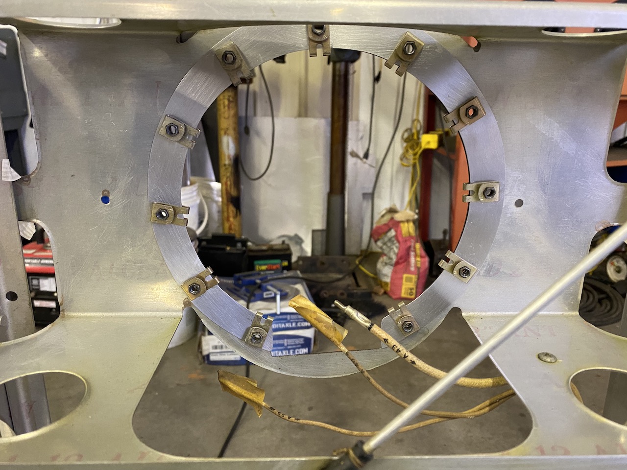

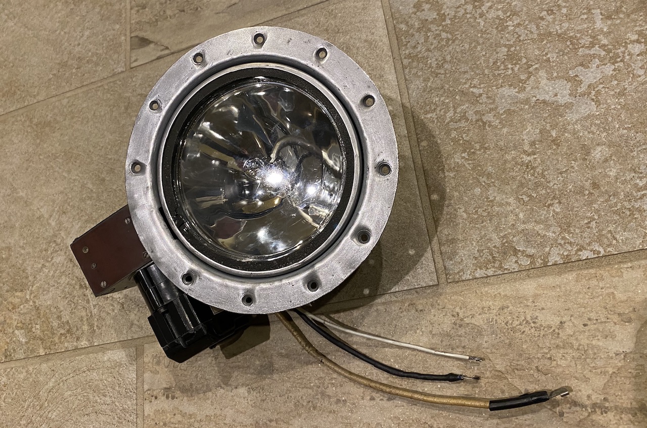

I would appreciate help on wiring on the Grimes Landing Light. I restored the light itself viewtopic.php?f=12&t=1137&start=80, so that wiring is not an issue and is safe and functional. However, there are old wires that are original and in good shape but I would rather not use as they are 73 years old and the wire couplers do not seem to match the lamp.
I have had people refer me to charts and talk all kinds of amp and length stuff but that might as well be like asking me to play the violin. I may make it squeek a sound but it will most likely not be right. I have little electrical experience or knowledge.
The motor itself (13VDC) uses the cloth covered wires marked <-A 39-> and <A 40->. They appear to me to conduct 4 amps to operate the up and down movements of the motor. I don't know for sure. That is what I have found on a blog of a Cessna 140 restoration. Its fuse on the panel is a 10 amp shared fuse.
The wire marked <-A 43-> is to the bulb, a GE Sealed Beam, part No. M4522 (250 Watt, 13 Volt, PAR 46 type - 4522). I am guessing it draws 20 amps based on Neil Wright's info I found here. The fuse is 25 amps.
I am really wanting to order the correct MilSpec wire to replace these old wires. Does anyone have any clue what gauge these are and / or what I could replace them with? Please, no charts. I have them, to include the A&P FAA charts that tell length & amps, etc., but that is like showing me Chinese. The part numbers on these old wires meant something. They had to have had a gauge and a rating. All I am trying to figure out is how I can get 25 ft.(?) of wire for each and replace these old wires so I can close the wing. I estimated I needed about 15 ft. from the lamp through the mount then rerouted along the wing spar grommets to the wing root. The originals appeared to be connected at that point to the receiving wires that went to the bus / panel (estimated at another 10 ft.)
Has anyone out there replaced these wires and been signed off--or signed off yourself if an A&P--some replacement wires for a standard Grimes 3905 Landing Light? And if so, what did you use?
