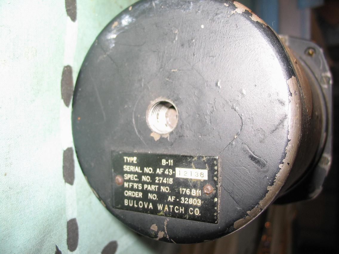

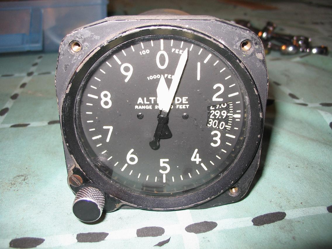

Can someone school me on altimeters? My ancient Bulova Watch Co. unit didn't pass a bench test when I questioned it's accuracy (leaks past the adjustment knob). Do I need to replace with a TSO'd unit? If my local avionics guy doesn't have an exchange unit handy then I either send it in for overhaul or get a new unit. My IA is not in town so am doing my own homework (yes, I'm impatient). Pity my old altimeter is on the fritz, I kind of like the idea it was made by Bulova Watch Co.

Roger that. Shipped off to a Wichita instrument shop today. They are curious of the Bulova manufacture but at the least can exchange, hopefully overhaul.

I'm not saying you're wrong, but, the 120/140 predate the concept of "TSO" so the originals were not "TSO'd". Also, the "Sensitive" altimeter was optional. (The "insensitive" ones had 100 foot graduations.)
The question has been floating round the internet since the beginning, without resolution. My take is the TSO lets the A&P off the hook of deciding if the instrument is acceptable or not.
(BTW, the Bulova part is a military part and doesn't appear to have a TSO tag, nor is it original...)

I found this online, I agree probably not original to the plane but apparently built 3 years before it. The instrument shop says it's probably a Kollsman model made by Bulova, they will cross reference the AN numbers for their paperwork. I like the history.(BTW, the Bulova part is a military part and doesn't appear to have a TSO tag, nor is it original...)
