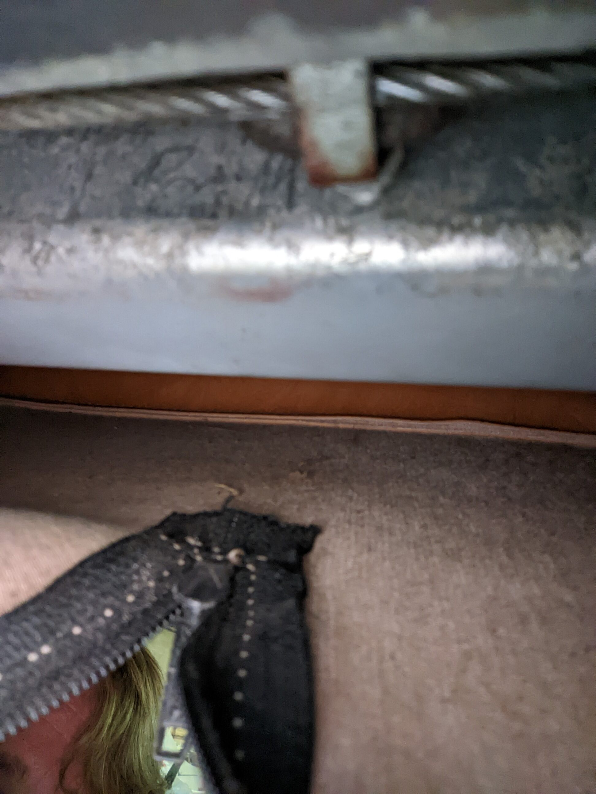

I looked at a '47 C140 today, and have a few concerns. It looked serviceable and like it was being taken care. Ragwing, needs some cosmetic work but flyable. I looked at the rear carry thru, and can't figure out what was done to it. It looks like it had been cleaned with something, and looked pitted. So, maybe it was cleaned and treated at some point? Not sure if that is an acceptable MOC or not? I tried to upload a picture, but can't seem to get it to work. The other issue is the engine, it has ~650 SMOH on it, but the overhaul was done in ~91. So that is a slight concern too, I could get lucky.

Don’t know the limits on the carry through spar. My IA had a wing off for a fuel tank repair. Announced he was going to take a look at the spar. I went an hid in the corner of the hanger with my fingers and toes crossed. It was fine, actually looked great.

You need to look for delamination of the spar carry through. Delamination will be most prevalent at the edges. Especially the forward edge.
If it has been over on its back from a landing mishap, look at the forward spar carry through for being bent.
That is what I found on mine and what ultimately became a ground up restoration. I ended up replacing both of mine for these reasons.

I would suggest getting a knowledgeable Cessna 140 person to do a prebuy. Preferably an A&P.
It could save you a lot of headaches and money.

Thanks for the advice on the picture, resizing the picture worked.
