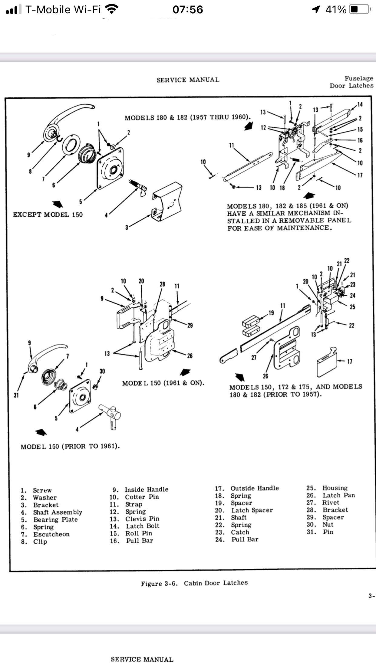

I have had problems with the right door.
The previous owner used piece of wire to connect the handle and the door latch. Go figure???
I looked at drawing and shows a flat bar.
Any one know where I could get one?

I am in the process of restoring an old beat-up 140 and finished the work on the doors a few months ago so I know what you are looking for. The “bar” is nothing but a flat strap of 2024-T3 aluminum. I made new ones for my doors because the holes in the ends were alongated. They are very simple and easy to make. I can measure one of the old ones for you if it will help.

Thanks for the info. I found one for the right side and will install it later in the week. If was home in my shop, I could fabricate one. Wont be home till sept, to hot in AZ. I found one on ebay and plan on installing it soon. I let you know if i ru into any problems. This is the schematic i found on it.
- C140 Door Bracket.jpg (298.22 KiB) Viewed 1751 times
