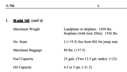

Reference from the FAA AC43.13-1B
g. The oil system should be filled to the
quantity noted in the TCDS or Aircraft Specifications.
When weighed with full oil, actual empty
weight equals the actual recorded weight less
the weight of the oil in the oil tank( oil weight
= oil capacity in gallons x 7.5 pounds). Indicate on all weight and balance reports whether
weights include full oil or oil drained. (See figure 10-9.)
Here is the oil capacity & moment in our TCDS under Empty Weight C.G. Range
NOTE: On Civil Aeronautics Regulations (CAR-3) Certified Aircraft, the
weight of the oil was subtracted
mathematically to get the empty
weight. In 14 CFR, part 23 aircraft,
the weight of the oil is included in the
empty weight.
