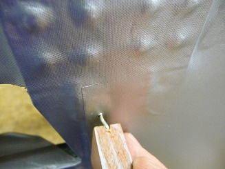

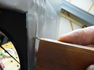

Re: Fabric clip installation
As Andy suggests, I used a piece of timber approx 1.5" wide with a groove filed into the end to locate the clip... A rocking action easily pushed the clip in.
- Without the use of the clip tool!!

46cessna140
- Posts: 13
- Joined: Wed Jul 08, 2020 4:04 pm
- Name: David C
- Location: Owasso, OK
Thank you! Following your method worked fine to install clips.
