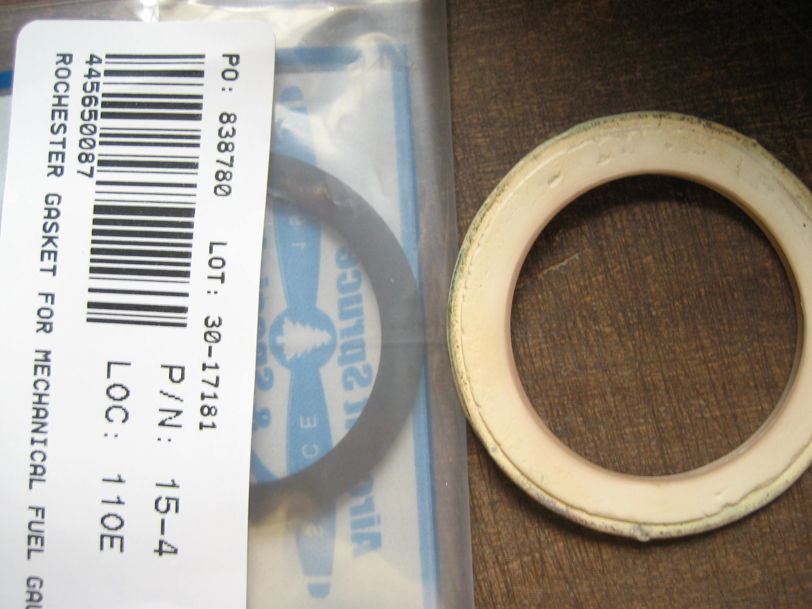

Hi George.
I have AS&S open buying bolts, so I looked up the gasket:
https://www.aircraftspruce.com/catalog/pnpages/15-4.php
I went to the gauge first and the gasket is listed as an accessory along with the float.
Gauge:
https://www.aircraftspruce.com/catalog/ ... _gauge.php
I haven't purchased/installed this gasket, but it is the part number Mac gave us.
Hope this helps.
Steve A H

Re: Fuel gauge removal
Here y'are. Actually, the one I removed (Right) appeared to be wrong one (a bit too wide), 'though had been there for many years with no leaks. The 15-4 fits and works perfectly. It's good to get one that's as fresh as possible when reinstalling & Spruce does claim to "rotate their stock". Mac

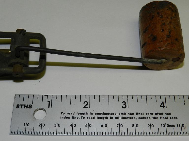

- Posts: 562
Here's a shot from an original gauge to show the length of the rod, the newer Rochesters are definitely too long.
- 2-1-15 067.jpg (63.95 KiB) Viewed 4149 times
