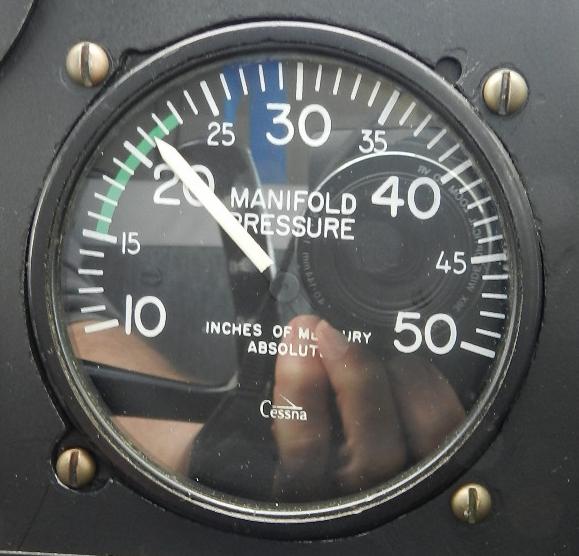

6597 wrote: Tue Jul 28, 2026 9:37 pm I do have a manifold pressure gauge, why it was installed years ago is a mystery.
Do the logs show it ever had a Beech-Roby prop installed?
Planes with adjustable pitch props will have a manifold pressure/RPM chart to use to calculate power and fuel flow. The RPM/prop load chart we have assumes full throttle operation. There are a lot of variables that affect fuel flow besides RPM. We don't know which ones they speced to get the numbers on the chart.
Check your MAP gauge. It should read ambient barometric pressure with the engine off. At full throttle (engine running) you should see about 2 inches less than baro. Any reading less than that is going to result in lower fuel flow than the chart shows. Any conditions less than standard (29.92") is also going to result in lower fuel flow, including at altitude.
If you can find a copy of the Continental Engine Operator Manual for the O200 it will give you some typical figures for partial power operation.

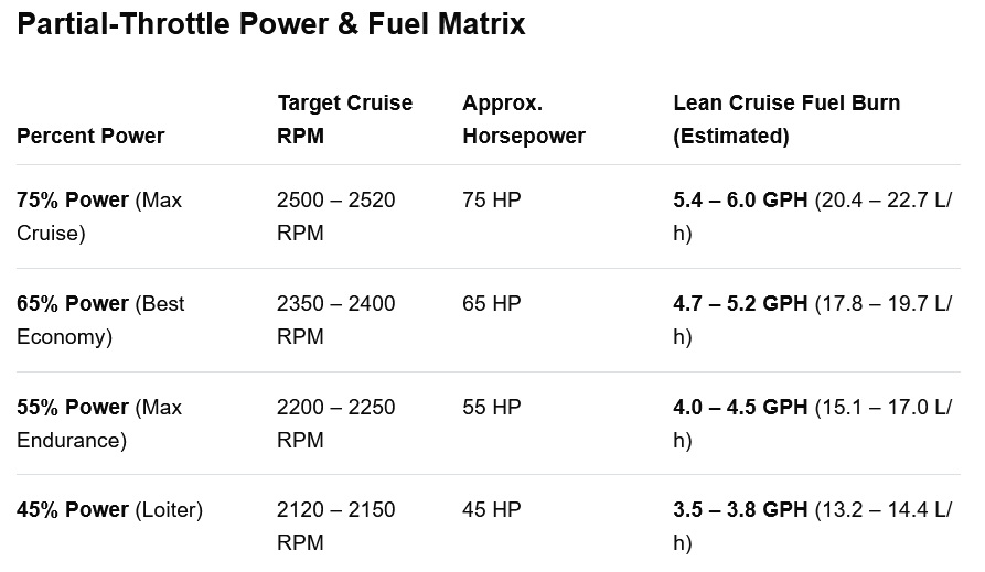

Here's a chart I found on the 'net. Trust but verify...
O200 partial power chart.jpg (84.01 KiB) Viewed 854 times

I was thinking over what I said about propeller load meaning full throttle and enough load to bring the RPM down to 2450, or whatever. This is not correct. What it means is enough throttle to turn the prop to the specified RPM. The problem is, it doesn't take into account things like prop pitch, density altitude, climbing, level or descending, draggy biplane or modern, slippery carbon fiber homebuilt, etc.
You can be certain that it takes more throttle to turn the prop 2450 on an engine on a test stand than it does on a plane that is designed for low drag.
So, again, we have too many variables to make a valid comparison.

Cruise manifold about 21", I did check the MP gauge as per John C and it was about as OK as I could tell with ambient.

Going from 4.5 to 5gph the only thing that stands out is my altitude on the low gph was high and the somewhat higher gph was at low altitude. If anything I think the MP was a little lower on the low gph.
That makes sense; less air calls for less fuel.
