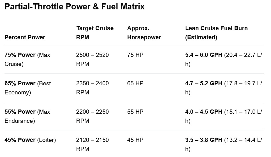

Here's a chart I found on the 'net. Trust but verify...
O200 partial power chart.jpg (84.01 KiB) Viewed 291 times
Posts: 2757
Re: 0-200 gallons per hour....
I was thinking over what I said about propeller load meaning full throttle and enough load to bring the RPM down to 2450, or whatever. This is not correct. What it means is enough throttle to turn the prop to the specified RPM. The problem is, it doesn't take into account things like prop pitch, density altitude, climbing, level or descending, draggy biplane or modern, slippery carbon fiber homebuilt, etc.
You can be certain that it takes more throttle to turn the prop 2450 on an engine on a test stand than it does on a plane that is designed for low drag.
So, again, we have too many variables to make a valid comparison.
