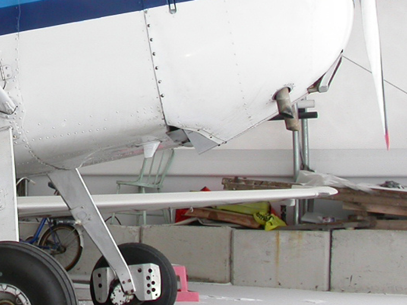

Is the 1948 C-140 supposed to have that "lip" at the bottom openning of the engine cowling sticking out for about 1/2 inch in the airflow as I have seen on many 120/140s ?
Mine does not, but has an extension instead narrowing the cowl bottom opening plus rounded lips on the bottom of the firewall, a la homebuilt, each side of the gascolator (approx 5 inch diam. bend).
My AME would like to see a more standard layout to make sure we keep those new cylinders of mine properly cooled. The previous owner seems to have made some temperature measurements and they seem to work (have some graphs in my paperwork), but they are definitely not original looking ! :shock:
My C-85-12F has the C-150 exhaust STC. You can see a little bit what I mean on the attached picture.

I made a post in your parts wanted ad about this but the "48" lip may be longer then the one on the "47" and earlier models. Also, it looks like you may have your stacks reversed. I believe that the slant of the pipe is supposed to go the other way, something having to do with keeping pressure on the exhaust instead of sucking it out, I could be wrong but the other way is how I see them on 150's.

The cowling lip you refer to is required for C-90 and 0-200 engine installations. It is not needed for any C-85, although I suppose if your engine was running hot, it is a Cessna part and would be able to be installed with minimal fuss.
The cowling lip you have is something unique to your airplane, I've never seen one like that. Do you have a 46 or a 1947 aircraft? A 46 cowling drops down lower (towards the ground) than a 47. Thus a 47 has more benefit of a cowling lip than a 46 would.
Your exhaust pipes are backwards. Spent a lot of time talking with people who should know, and the sum total of what everybody said, who's opinion I respect, says the slope of the exhaust pipe should match the slope of the cowling. Mostly to keep the hot exhaust gases off the cowling. I've tried turning them both ways and was unable to perceive even the slightest difference in power.

Well, well, well... So my exhaust pipes are reversed ??? :? You learn eveyday in here ! I'll have that fixed on my next visit to my AME, for sure !
As for the lip, indeed, I have not seen any like that before, thus my asking. So apprently, I would not need one ? If anyone could post a pic of what they should normally look like on a 1948, I would appreciate. I have the C-85 engine.

If you look in the TC under "optional engines" part of the C-90 install is to install Cessna doubler (p/n XXXXXXX) (i.e. the cowling lip).
I have both 0-200 STC's of about 15 years ago and the one I used to install my 0-200 required the cowling lip, and I need it, my engine oil runs on the warm side. I don't recall what the other STC said and it's at home and not available to look at right now. I'll check on it though.
If you look at a 46 cowling vs a 47 and later, the lower lip of the cowling on a 46 hangs down more into the slipstream and I suspect provides for better cooling. (no facts here) My 47 needs all the help it can get I'm thinking of enlarging the lip on the bottom.
Michel, I would have to see your airplane, or better pictures, my guess is you could remove what's been added and you would be back to an original arrangement. And it would probably work just fine.

Victor, next time I go the the airport, I will take much better pics and post them here.
I don't have the figures with me now but I'll give you my temps as well.
About the exhaust pipes, is it only the stacks that are reversed ? Can they be simply turned faceward or it needs more work ? I never looked at that area that carefully so I don't remember how they are mounted...

I don't think that I would be so quick at this pipe reversal thing. When you start looking around you will see them both ways. I prefer the slant to be forward. Someone went to great lengths to center your stacks in the cowl opening. Most of them are curved and will come out of the cowl in different places when reversed. Yours look long enough that they can be recut to face forward and only some will think they are correct then. Like Victor said the engine doesn't run any different.
I agree that if you just removed that extra sheet metal the cowling would look original. In a hot climate the proper cowling lip provides extra cooling.

Randy is right, swapping stackes from one side to the other (which is what you would have to do) may well change the position of the stacks causing you to have to move the holes (something I have to do on my left side. Just trim them with a band saw to match the cowling contour and save yourself the grief.
The cowling lip hanging down in the slipstream causes a vacuum that pulls more air through the cowling giving you better overall cooling of the engine and hence lower oil temps :wink: I found when I put mine on it also change the trim slightly so beware the first time you takeoff after you put it on.
