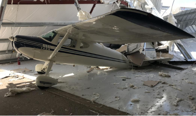

I'm rebuilding a 1950 C140A that was damaged by a hangar blowing down on the tail. It's a fairly clean air frame, but has had some neglect over the last 30 years of the same owner.
I've completed the repairs of the fuselage, and have all the tail parts to repaint and install. I'll save showing photos of the repairs till the old girl is assembled.

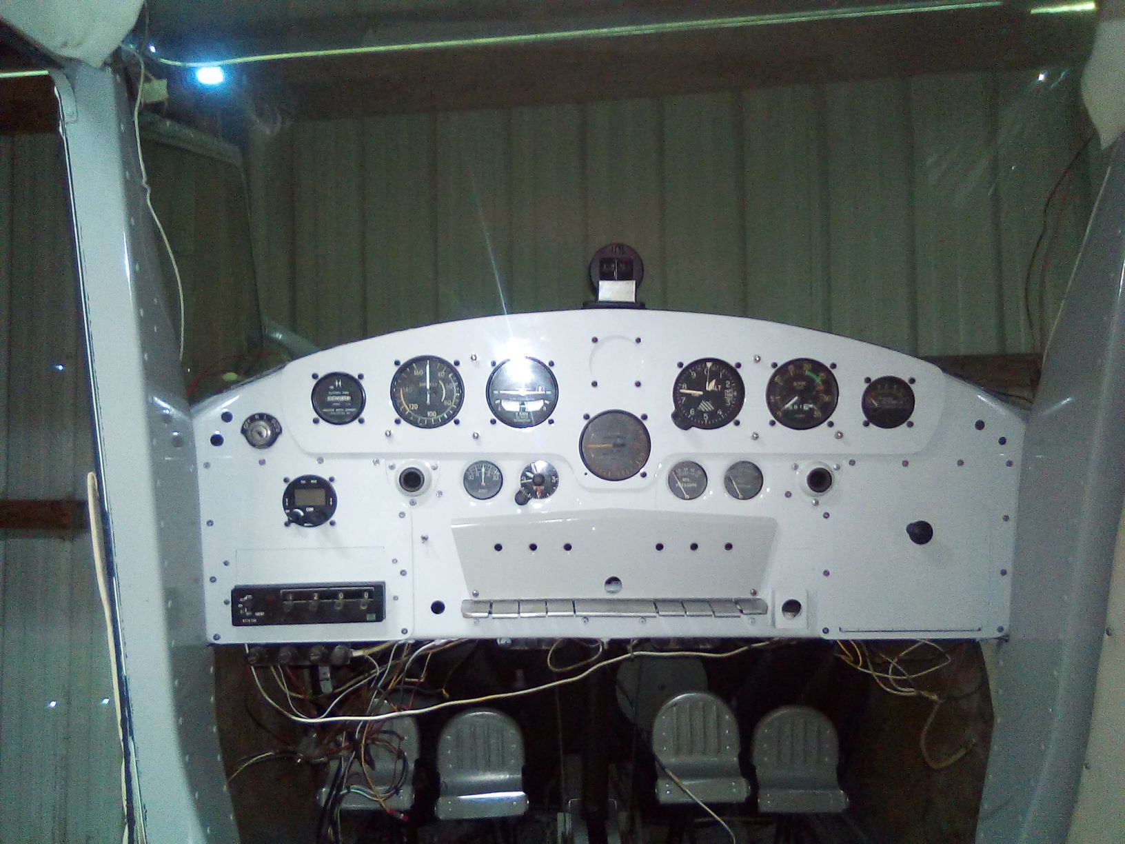

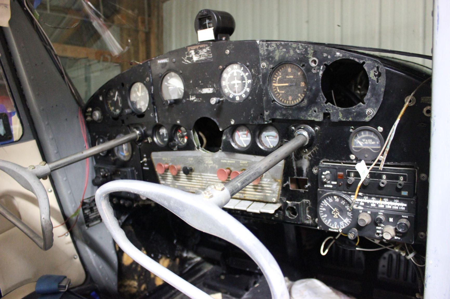

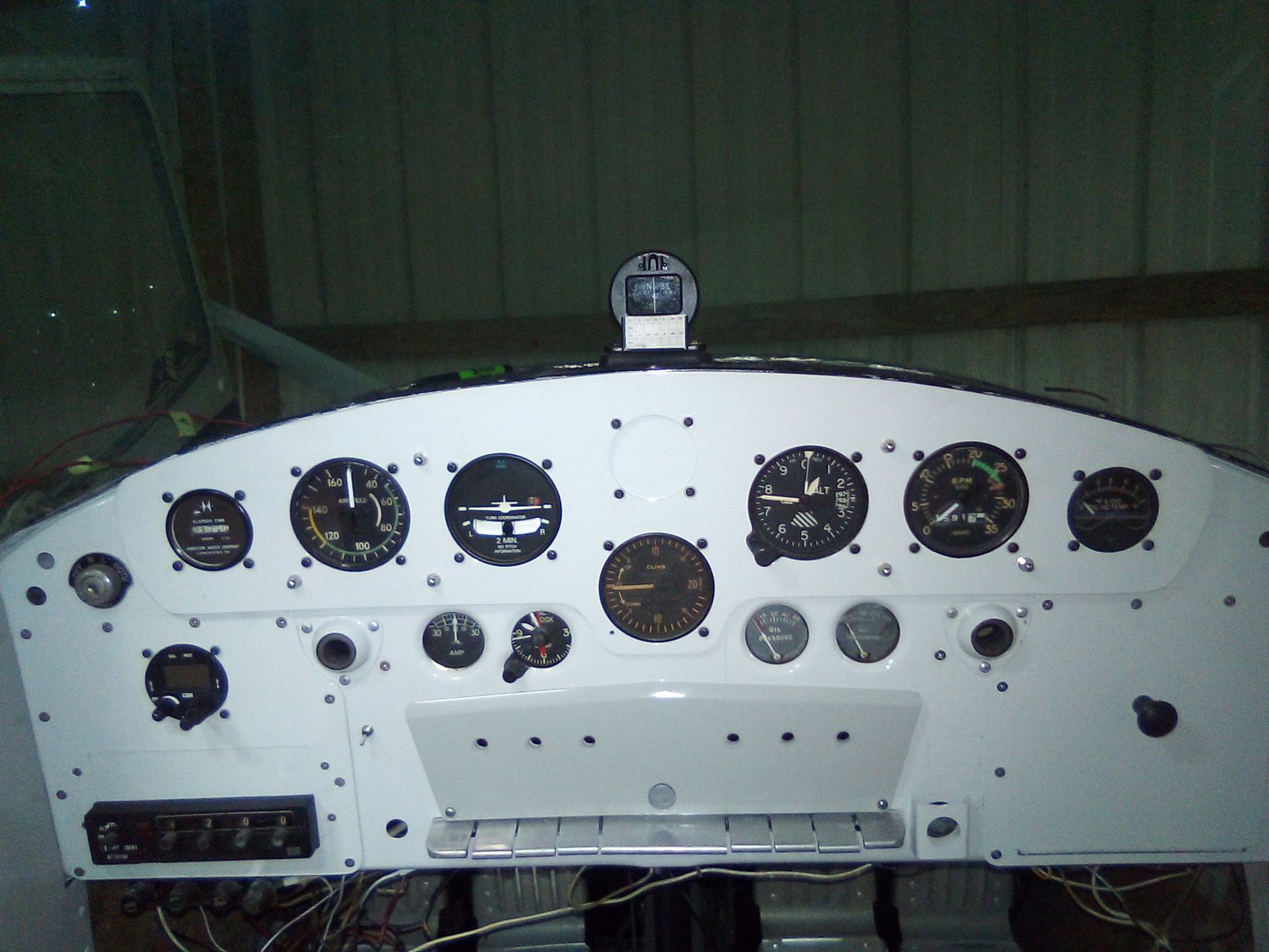

The plane was IFR capable, but was a total disaster from the seats forward. Lots of stripping cleaning and rebuilding from the floor up. I have a few before and after photos to show the progress. It's not original, and I don't have the money to go that route, but it cleaned up to be a pretty nice VFR panel.
I think she'll be a fun plane with the O-200 and at least 30 lbs lighter after the change from IFR to VFR capabilities.

- in 00.JPG (241.36 KiB) Viewed 85538 times
- N95L panel 11.jpg (246.89 KiB) Viewed 85538 times
- N95L panel 22.jpg (262.55 KiB) Viewed 85538 times

Here she is with the hangar on top of her tail.

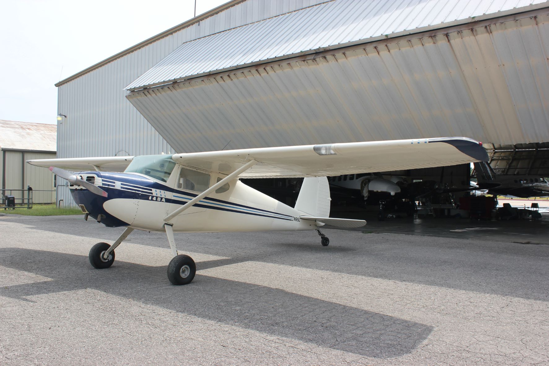

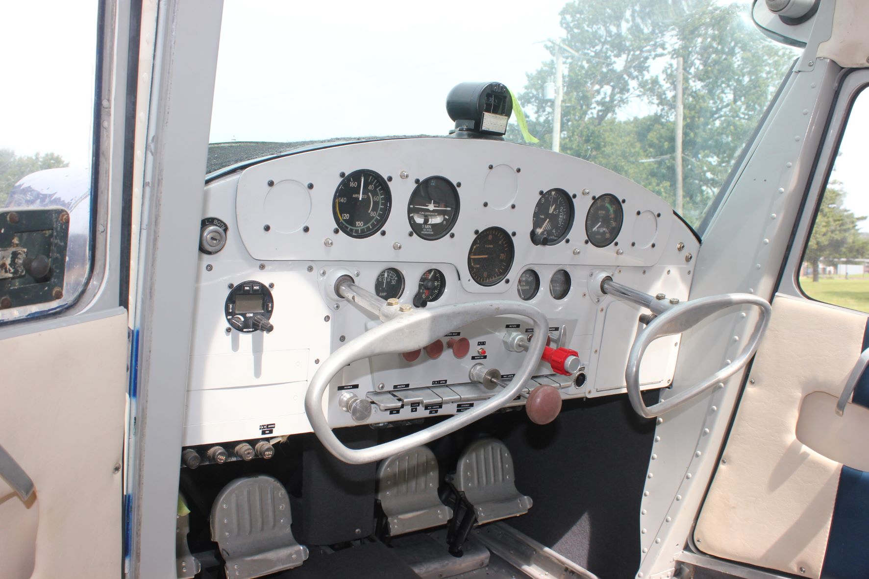

N95L is an airplane once again with some new skins, stabilizers, elevators and rudder, and a lot of clean-up work! Also did the O-200 STC. Happy days are here again! New empty weight 1,032 lbs. Original weight, 11/29/1949, 962.5 lbs. (Both weights w/unusable fuel and no oil)
- N95L 11.JPG (217.57 KiB) Viewed 82435 times
- N95L 10.JPG (324.59 KiB) Viewed 82435 times
