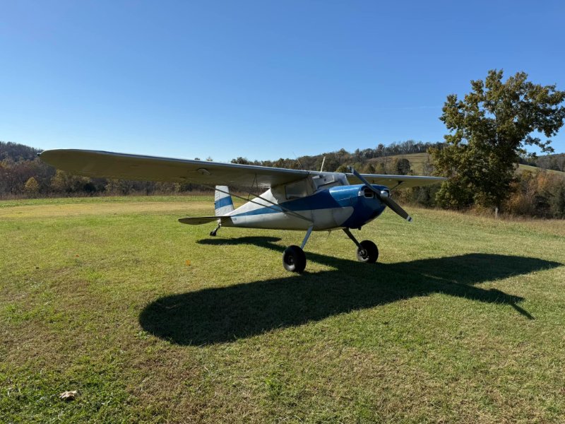

Second Annual done! I just wrapped up my first field approvals on the solid Grove Axle and doing the Aeroclassic 8.50's. I'll be sharing a video on my youtube channel on that process soon. Gone flying!
